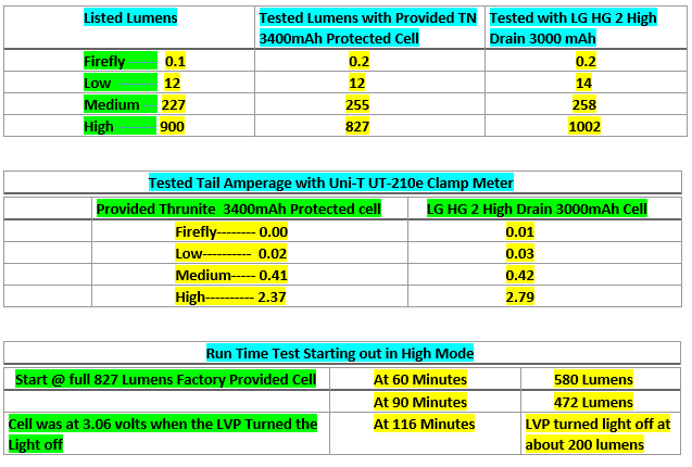

Below are charts for the Listed and measured Lumens , the measured tail amps and the one run time test I did with this light.
