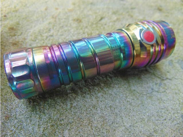

This is a single 18650 powered light and it is made of Titanium that has been heat treated to get the very brightly colored rainbow effect. Each light will look slightly different as the process used for the heat treat is not an exact science , so I guess these lights will be like snowflakes and no 2 are the exact same.

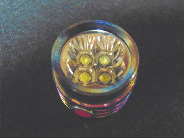

The emitters (4 x XP-L2) sit in a nicely made smooth , quad reflector made of Aluminum. The reflector design looks to be well thought out and has spots made on the back side to clear the solder joints and the screws that hold down the MCPCB.  The emitters each sit well centered in the perspective holes and the MCPCB is a DTP copper board. The light comes in a neutral tint (4500K to 5000K) and also in cool white (6000K to 6500K) and the E1+ is rated at 5000 lumens in Turbo mode.
The fins are well cut and there is a "flat" where the bright red side switch button sits in those. Just under the side switch (on the tube) is the slot for the stainless clip to attach at the end of the "spiral" cuts of the tube. The clip can be put on the light for head up or head down carry and holds firmly either direction.

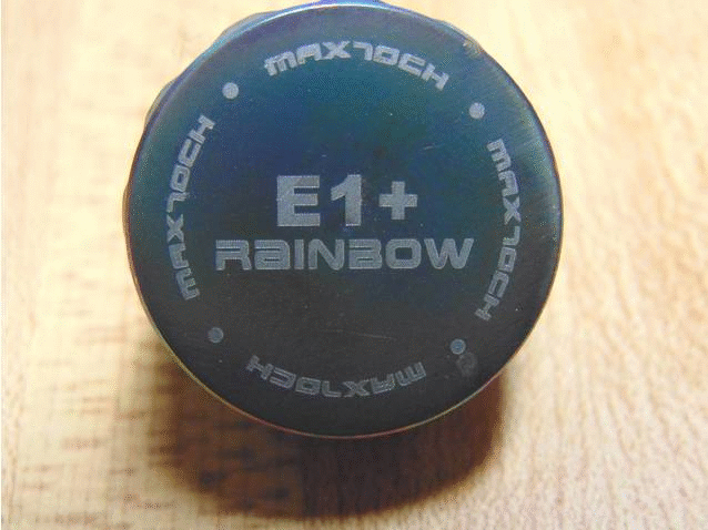

The only branding or etching on this light is on the end of the tailcap and is nicely done. The tailcap spring looks to made of copper instead of the usual plated steel. There is also a magnet in the tailcap , so the light can be attached to a smooth metal surface and it holds on pretty good.

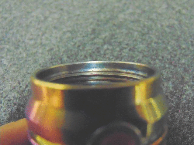

All of the threads on the E1+ are well machined and operate smoothly.

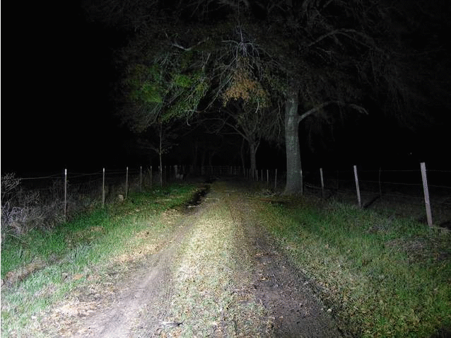

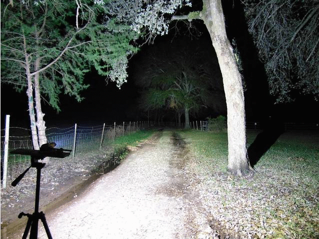

The beam from the E1+ , although floody does have somewhat of a hotspot in the center with the reflector in the head. It makes for a good flood with a little bit of throw to the light also.
100 yards to gate in High / Turbo......
75 yards to gate in Medium / High / Turbo.....
50 yards to gate in Low / Medium . High . Turbo....
Garage door 20 yards in Eco / Low / Medium / High / Turbo.......

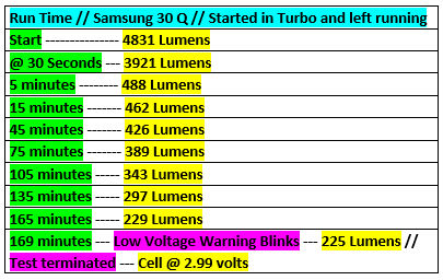

Due to the small size of this light , as with most small high output lights , the Turbo mode will only run for short periods of 30 seocnds as there just is not enough mass to move all that heat out quick enough.

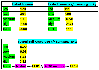

Here are my charts with the listed run times / lumens and the tested run times I got using a Samsung 30 Q cell , as well as my tested output on the lumens and tail amperage.
