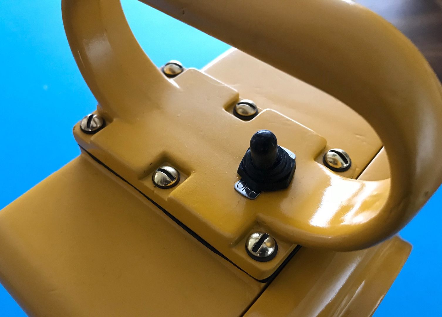

  • install new two contact rubberized toggle switches

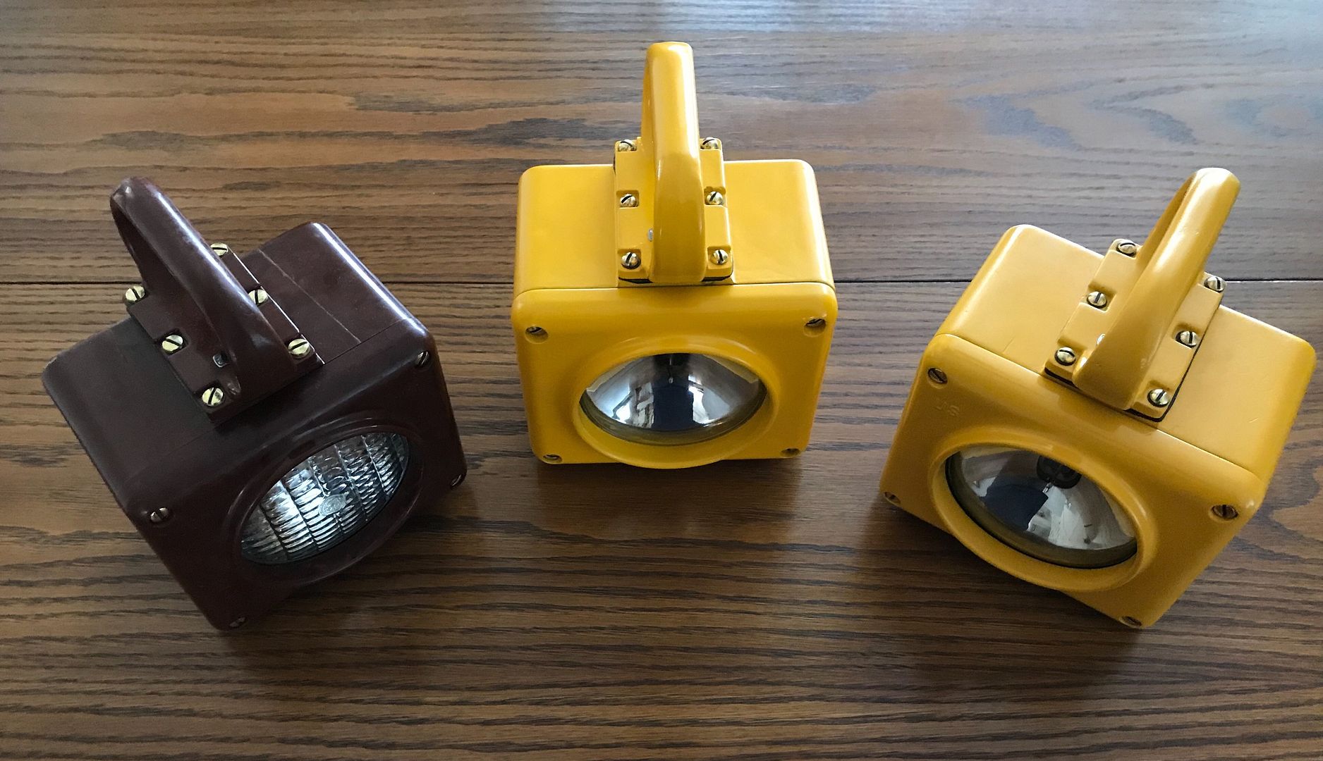

So here are the three lanterns completed:

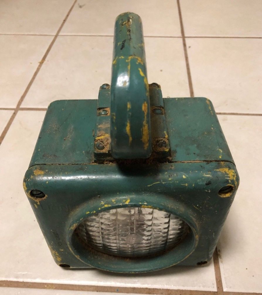

Firstly some before:
The green one:

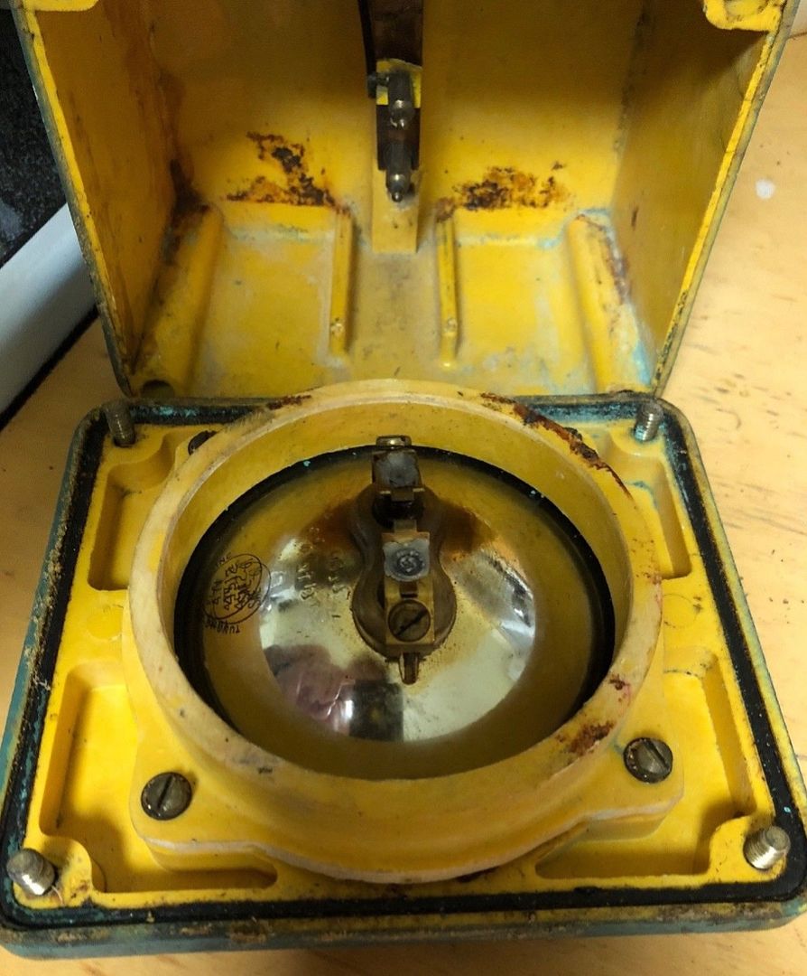

with badly chipped and worn paint.  Corroded contacts and stained interior, Broken toggle switch and some stripped contact screws.  One brass contact plate was badly corroded and broke (resoldered).
Exterior:
Interior:

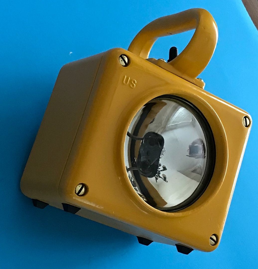

I wont bother with the other before as they are all similar,  here are the afters:
I will make a separate posting of the restoration of the interior and the rewiring of the 6volt parallel to 12volt in series if any one is interested.  I used a direct sealed beam LED tractor light direct swap for the GE sealed beam right down to the insertion tab.
Cheers, Geoff
