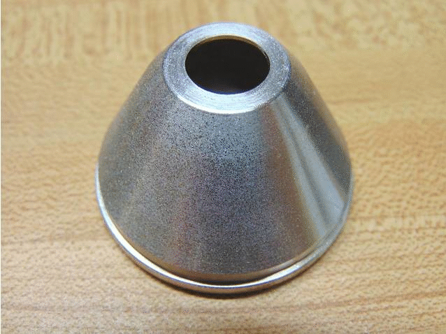

 The reflectors on these lights measured at the inside edge pf the bezels is…..A4 V2 / 41mm ….. D1S / 43mm ….and the Catapult V6 50mm. As you will see in the video footage (if you watch that) the little A4 V2 holds it own well against the larger V6 and has a little better throw than the D1S to my eyes.

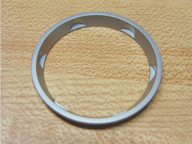

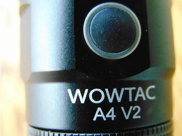

The branding / etching is done well on my sample as is the anodizing , with it having no pin pricks , thin spots or any other blemishes that I could find. The Switch button and USB port sit nicely in the body of the light.
The knurling is a square pattern , instead of the usual diamond shape on most lights (although we are getting more with different knurling now days) The square knurling is much like I have seen on the Olight products , although slightly different at the same time. It does have a very nice look to the knurling and also it has a really good feel in hand
The reflector on my sample is also made very well and had no blemishes or dust of any kind right out of the box. The AR coated lens was almost invisible right out of the box also. The XHP 35 HI emitter sits perfectly centered in the reflector.
 Although I forgot to take pictures when I had the MCPCB loose , it is all copper and of course I also forgot to check if it is DTP. I will try to do that after the holidays and update at that time.

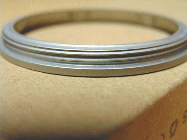

For those who like to mod , or just might happen to decide you want a different emitter (although what is in the light does a great job), the head of the light comes apart fairly easy to get inside. Also the smooth bezel makes for a good beam pattern with NO artifacts or weird shadows around the edges.
The tailcap has the lanyard eyelet that sits on the side of the tailcap , so if using the included lanyard , the light will still tail stand without the lanyard getting in the way. There are also double springs in the tailcap to help maintain better contact and decrease the amperage draw that comes with a single spring.
The threads are all very well cut and came lightly lubed on my sample. All the threads are very smooth to operate also.

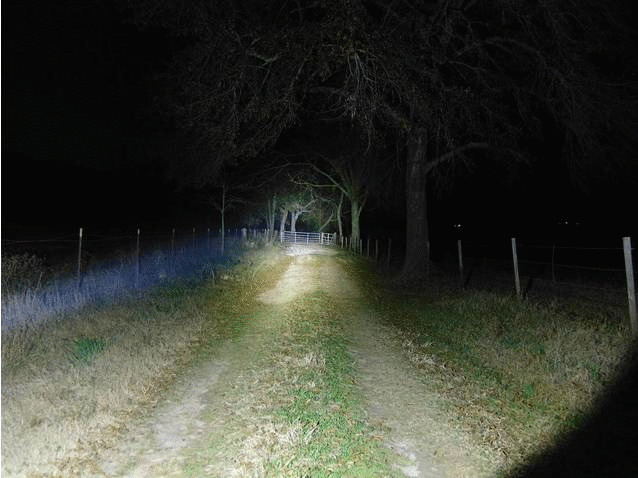

The beamshots……….
3 feet from garage door ….. Moon / Low
70 yards from garage …… Medium / High / Turbo
75 yards from gate ……. High / Turbo
100 yards from gate …… High / Turbo
155 yards from barn …… Turbo
175 yards from trees ….. Turbo

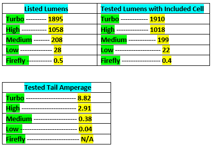

My tested run time , lumens and tail amperage charts……
Overall my opinion of this compact light is that it does a great job in the throw department , and the build quality and overall performance is exceptional , especially for the price point and what you get in the package. Just a great little light as far as I am concerned.
