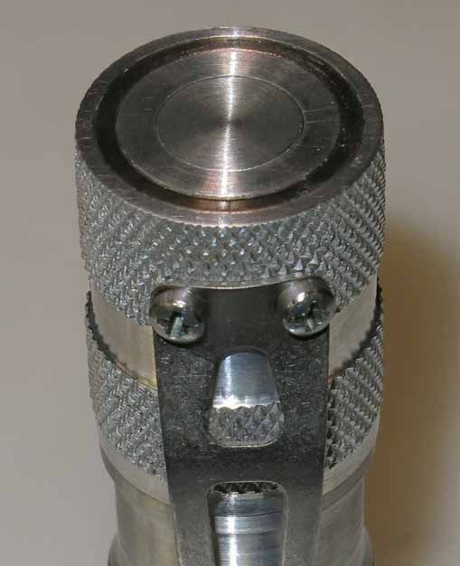

I really like the look of the tailcaps without a rubber boot and there is a round magnet out now for the tailcap of the Convoy. A clip was also added to prevent it falling out of my pocket. So far it works as its meant to.

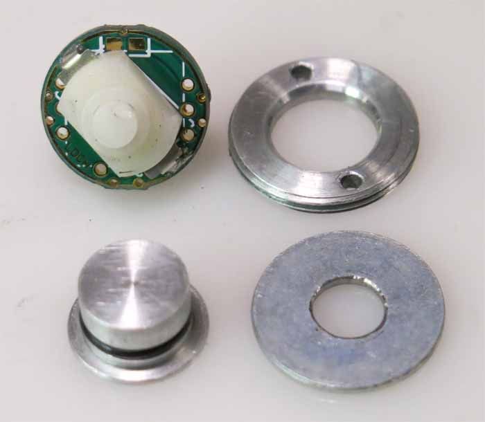

The insides of the tailcap include a IOS switch which is no longer sold and the switch button with an o'ring to seal out the grime from inside my pockets.

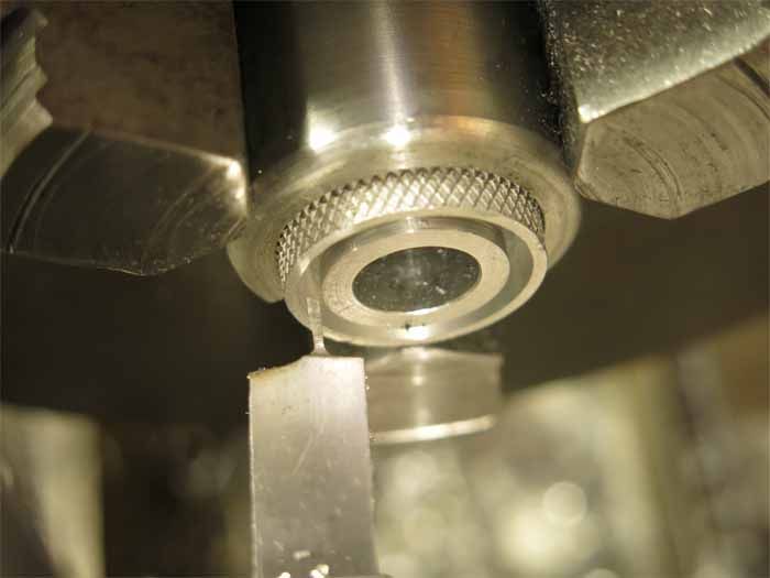

The groove in the tailcap was just a little nerve racking as the tool used to form the groove was only 1mm across the cutting edge and had to machine in a depth of 5mm.

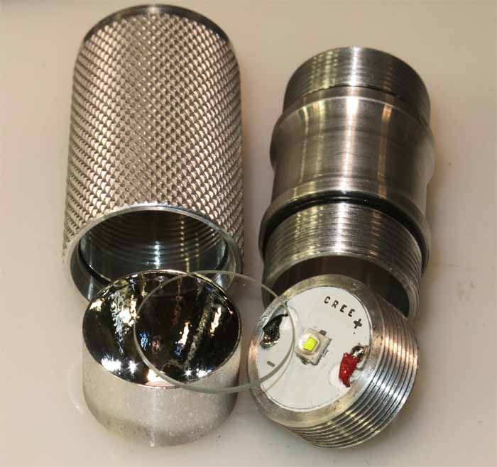

The components in the top end included my standard 20mm pill, 19.2mm reflector AR lens, 7135 driver with all the chips bar 2 removed for an output of .8amp on high and a torch XPE2 led. No copper star needed here. The battery used is a 16340.

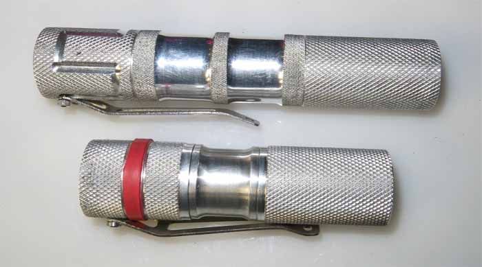

And finally a picture alongside its big brother which runs a 16650 battery.
The light works really well for what I use it for. It has a really tight beam and almost to much light on medium. The magnet attracts small particles of metal from pockets like a vacuum truck and the clip works as it should. Hopefully this one wont go the way of the last work light.
